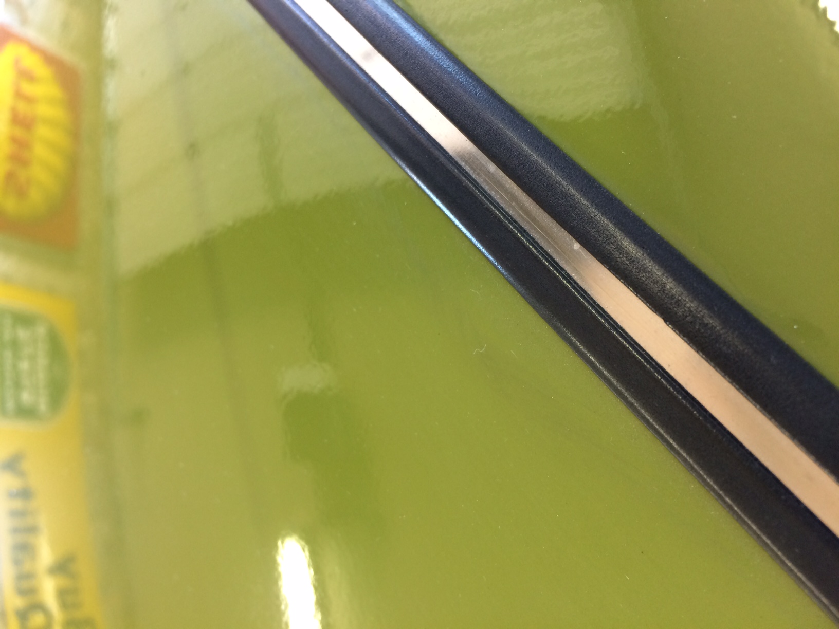

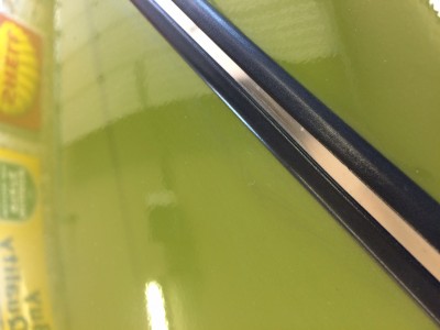

The plastic chrome within the rubber gaskets was junk. For a nice and even better alternative/replacement, I used thin strips of stainless steel about the thickness of a business card. I then polished them before I installed them. I used two strips per a side. They really shine nicely when in the sun light. Here is a photo in the shade.

Hello, �You c an also buy new replacement strips from Civic G Garage in Australia.� Here is a l �ink:� https://civicgarage.com/index.php?main_ ... 5_49_50_51
