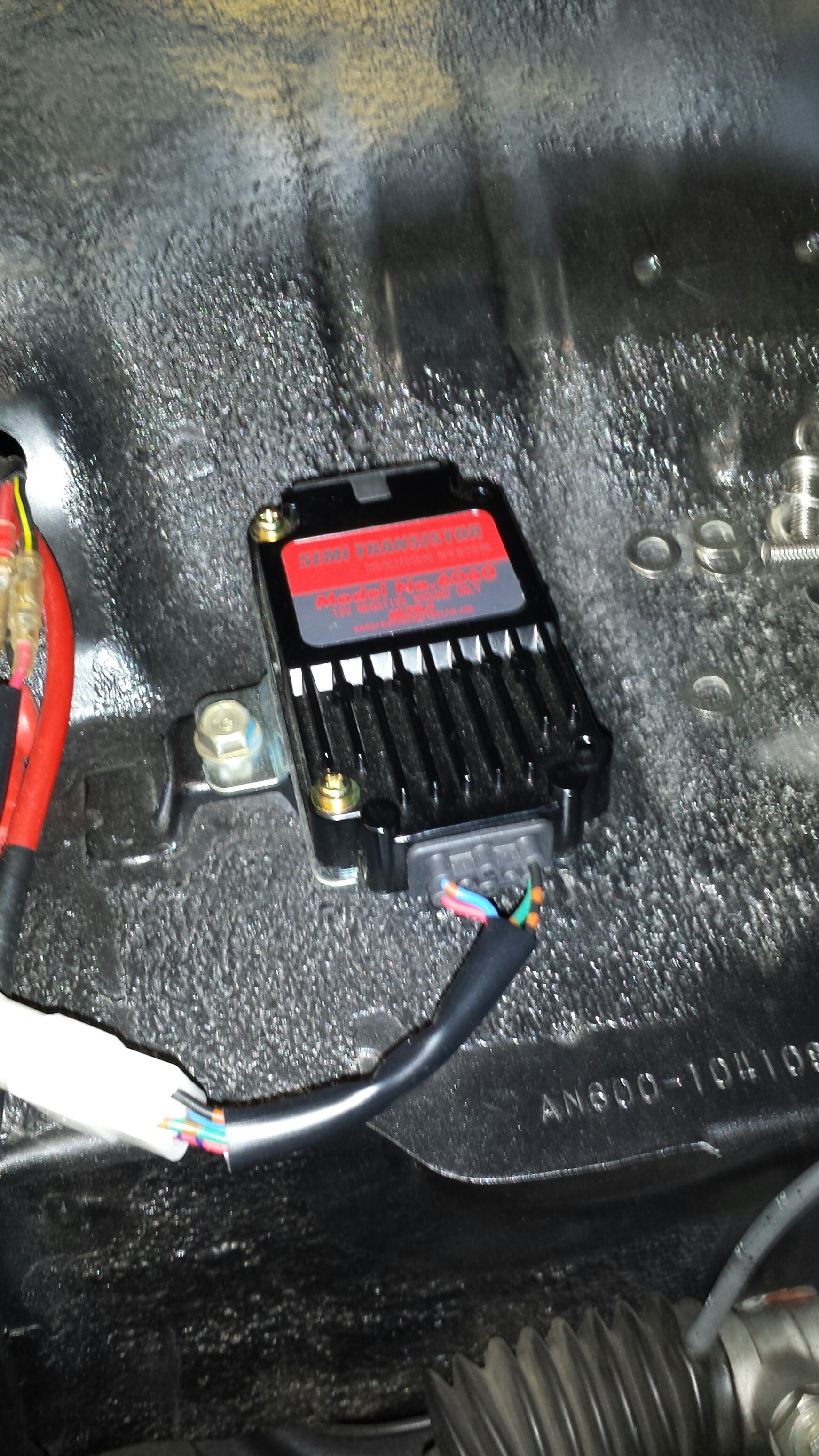

Hi,
New here, name is Art, there is a device also called an Ultra Semi Transistor ignition setup,  mainly seen in Japan that can be used also,  just installed one on my N600 recently.
Let me attach a pic.
Sent from my T-Mobile 4G LTE Device
