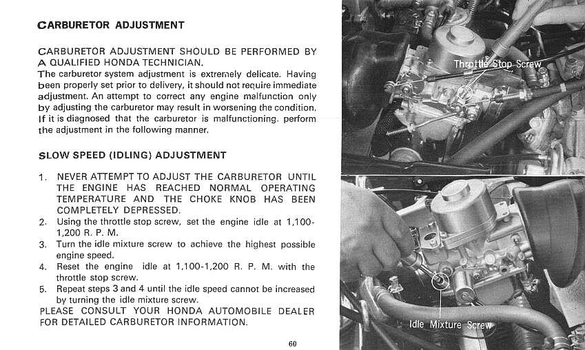

The Sedan Owners maual has the RPM goal.   See attached.
