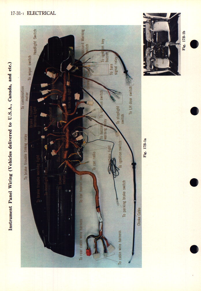

Y es, it should be under the dash bolted to the cross bar the attached picture should show the connection.

Thanks everyone. �Let the investigation begin! �If the hazard light works (i.e. turn signals blink), would that narrow down what to look at?
