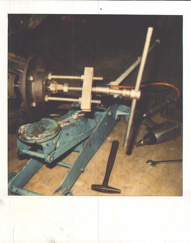

Miles is correct, the half shaft can be warn and result in slop where it meets the center of the bearing.
See the attached picture, you can make a bearing puller/axle removal tool.  Out of an old front brake disc. Drill holes to attached it to the knuckle and using a castle nut welded to a nut that will thread onto the puller and another nut to lock it in place on the puller tool shaft.   Once locked onto the puller the half shaft can be pulled into place or backed out.
