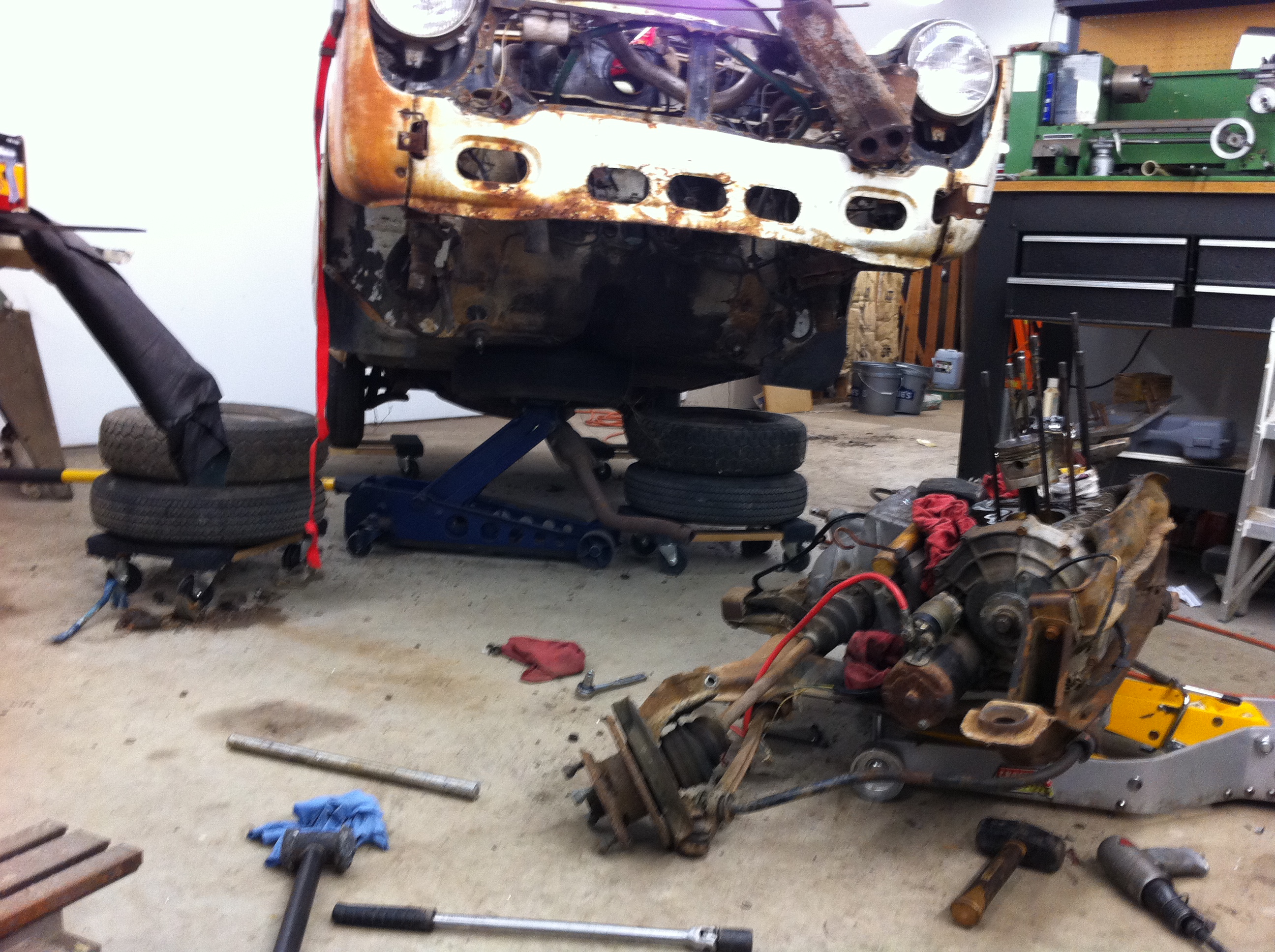

On my 1970 n600 that sat for 30 years, the driver side piston is really stuck in the cylinder.
so far I have tried
1.Penetrating oil (2 months , no difference).
I now have the engine out, the head off and the piston looks like it has melded against the cylinder wall. (no gap, it looks like its hard corroded to the wall. (Odd since the cylinder wall is smooth and the head looks great. I guess a little water got in or somehow dripped in it and caused this issue)
I tried beating the piston, drilling the top outer edge and more beating. (piston is now ruined, cylinders are probably hone-able)
Then I heated up the piston top using a mapp gas torch, more beating.
Then an air chisel around the top edge, more beating. All with no sign of it loosening.
My thought is now running to me cutting the cylinder vertically (down the front and down the back) and pulling it off the piston.
Piston is 1.6 inches down from the top edge of the cylinder. I have an aluminum bar between the block and steel liner at the bottom of the cylinder. (So the rod is not at the bottom of it's stroke).
If I had an acetylene torch, I would melt the piston out, but don't have one.
At some point, I will give up and get another engine. (I really wanted this to remain a numbers matching since it's a 1 owner texas car, 30k miles).
Does (has) anyone have this type of stuck piston and what did you do?

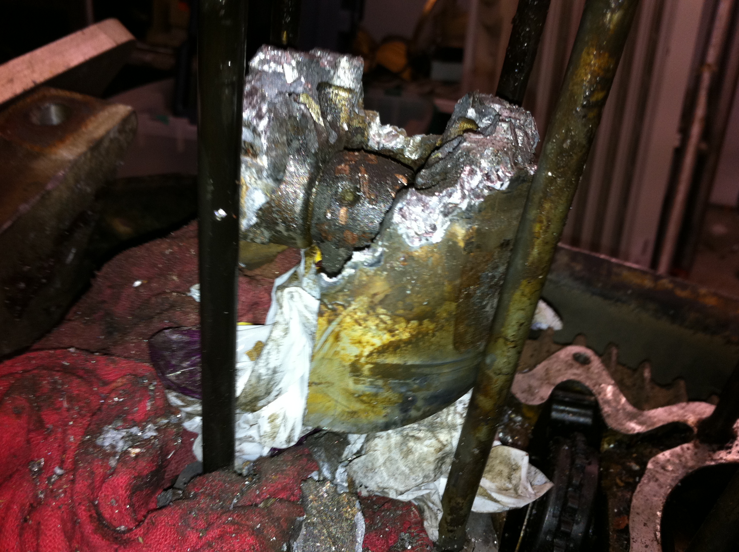

I got it apart today. I did it by using an air chisel (multiple tips). I broke the top out, then worked my way down one side. It was frozen all the way around.
I ruined one piston and I cracked the cylinder liner, but I feel happy to have finally beat this little darling into submission.

Just so we are all on the same page, the Honda 600 cylinder block is not sleeved they are part of the casting.
Re: one piston frozen in cylinder, need advice
I think you mave mis-read what was written. The cylinder has a steel (or maybe iron) sleeve or liner. I just walked out and stuck a magnet on it. The rest of the cylinder including the cooling fins is made of aluminum. Now, they may have cast the aluminum around the liner, but it's also possible that the liner is inserted after the aluminum was cast. Frankly, it doesn't matter to me which way it was made, the ferrous sleeve broke during my piston removal.
I said nothing about the block.
Richard
Richard
