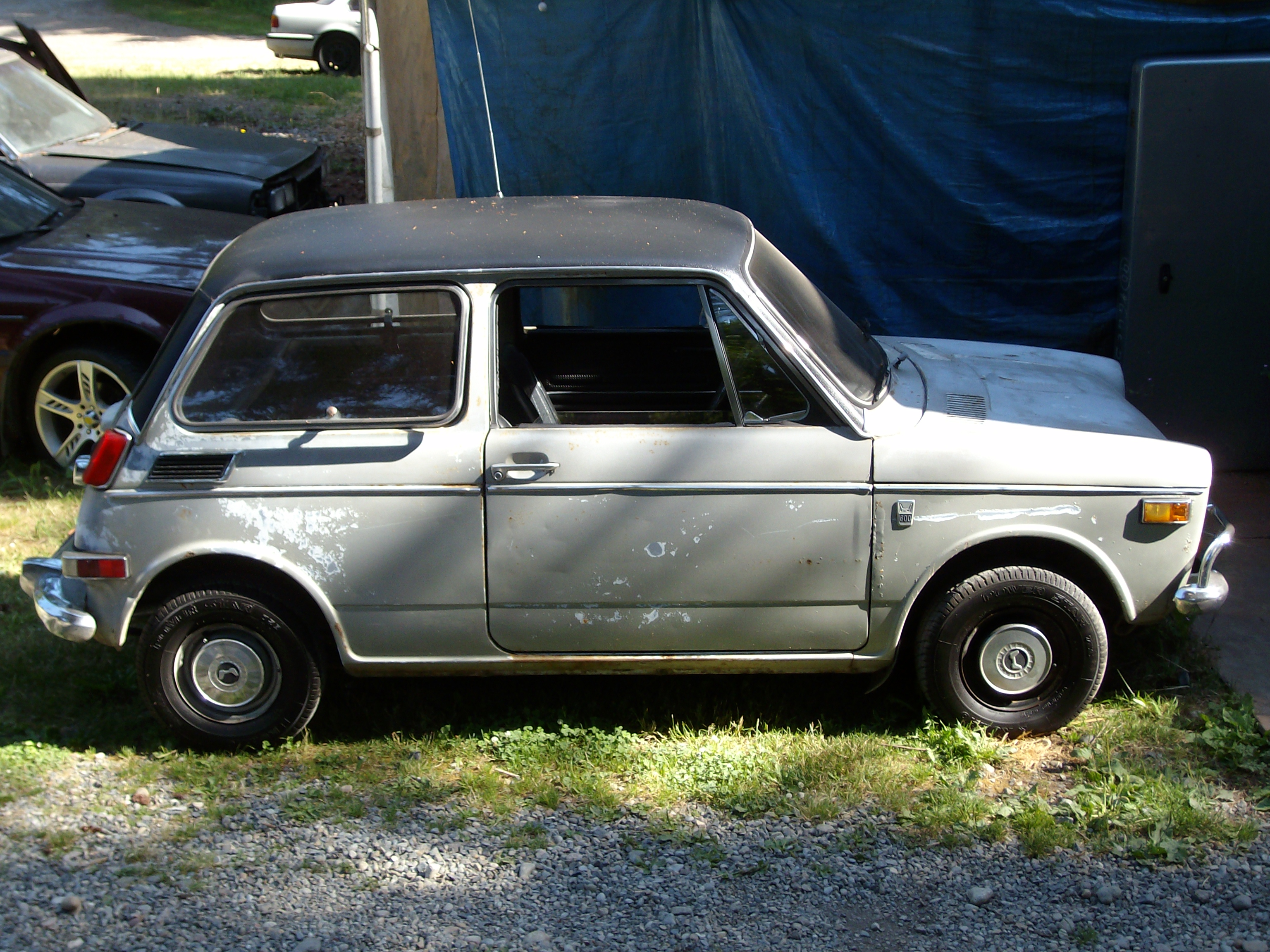

I am a new member, and have owned my 1971 Honda AN600 for a little over a year. My car ran pretty good up until last week, when it would just not start. Turns over, pumps fuel to the carb, but no spark anymore. I am in San Diego CA and looking for guidance with this. If I need a coil, where can I get one? points? condensor? Where do I start? Help!
Thanks in advance, Dave
Won't start, no spark, just quit on me
