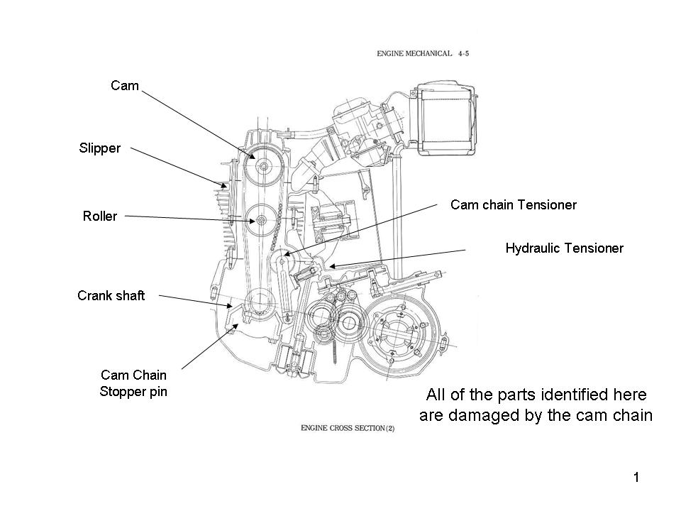

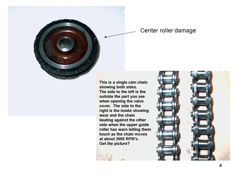

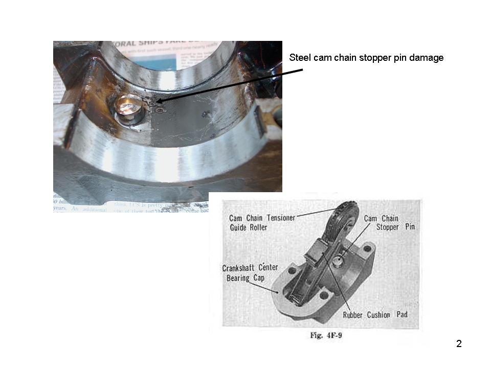

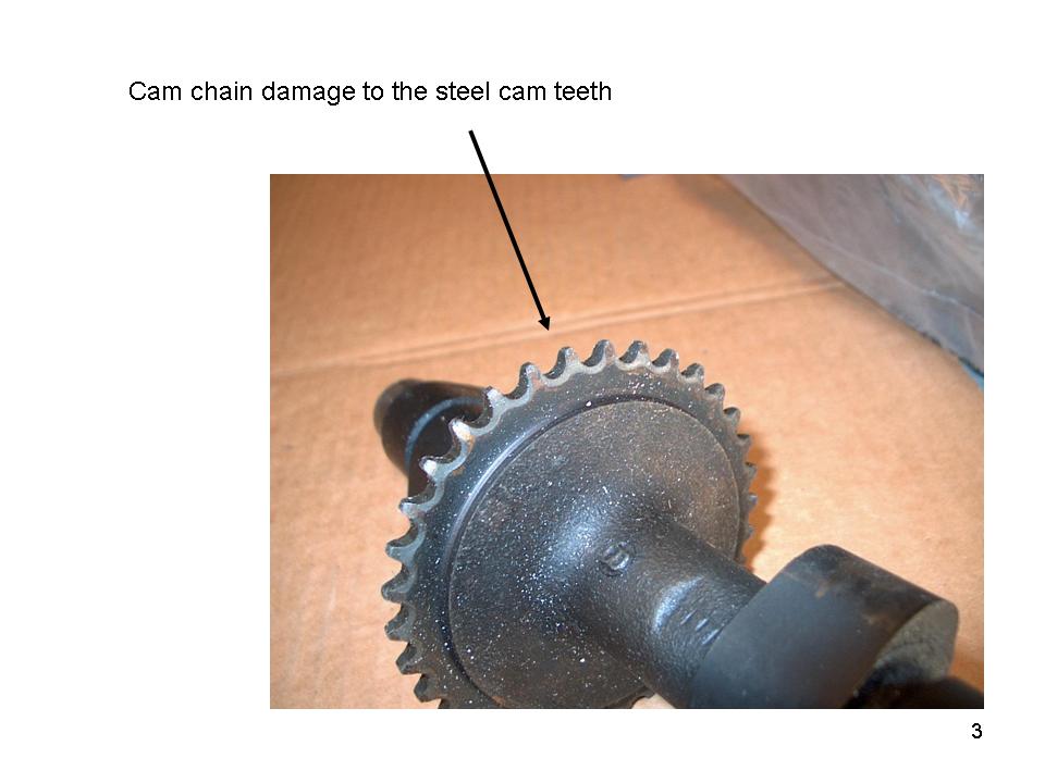

Re: Hi performance cam bearing mod for 600's plus other mods.
Richard;
The cam bearing/end caps do a remarkable job just as they are with out any modification.
Only when the oil pump fails do the bearing caps fail, not do to design but lack of lubrication.
On the steel center, tension rollers you talk about, see the attached pictures. Yes, a stretched cam chain creates more damage but it’s the stretched cam chain. It chews on everything and if the rollers are not changed when they too show ware they will allow more damage by the cam chain. But Honda didn’t use rubber rollers because it was cheaper, it’s because they work. As you can see in slides 2, 3 and 4 the cam chain does cause damage to the steel parts in the motor already. So why add another piece of metal for the cam chain to chew on 100% of the time.
I too have had over 40 Honda 600’s and have done considerable testing with different materials, for gaskets, rollers, slippers, dampeners to name a few, even to building a test motor to test parts I and others have made. Many have failed which caused changes so other parts could pass testing. Remember WD40 got its name from 39 failures.
But why in 1977 when thousands of Honda 600’s were still on the road, didn’t Honda use steel rollers or even a steel slipper? Because maybe with their vast R & D center they found that the cam chain with its ravenous attitude it would be better to use rubber covered rollers and slipper allowing some disposable rubber to fall into the systems oil than metal chips and do the job better.
Just my knowledgeable opinion.
