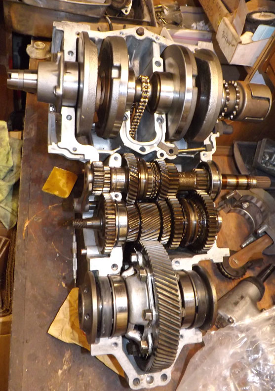

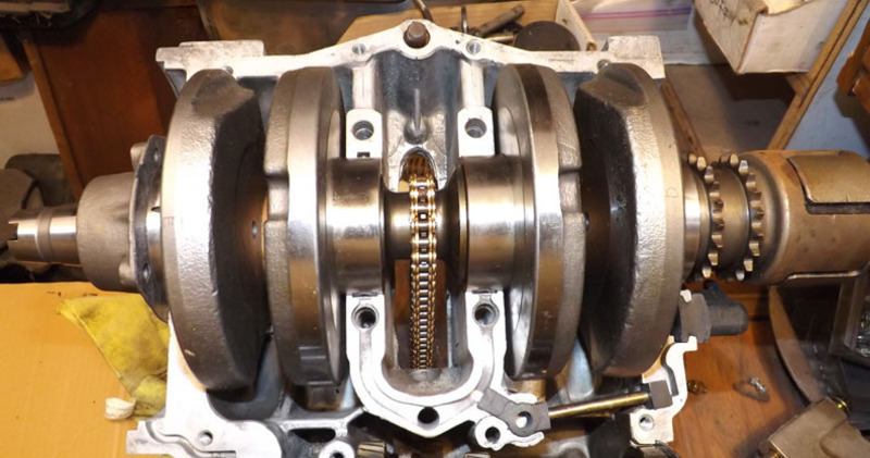

There is a spacer between the 2 crank end roller bearings behind the pulley but even if it was left out I doubt you could move it 1/4". The spacer is about 5mm thick. On the primary end of the crankshaft a bolt holds on the front sprocket assy tightly to end of crank and a locating pin locks that roller bearing to the case. Now if that spacer washer was left out you might get some end play but only 1/8" aprox.

I was thinking you were thinking .050" (close to 1.25mm) but there are no ball bearings in the crankshaft, it's all rollers.
I think if the pistons were at bottom of stroke and someone left out all the guide pins & spacers you could get lateral movement. I'm liking your theory on loose crank pulley.

There are pins for each of these crankshaft bearings, movement could be there if these pins were not in place.
Otherwise any side movement would be normal.
