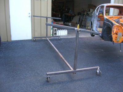

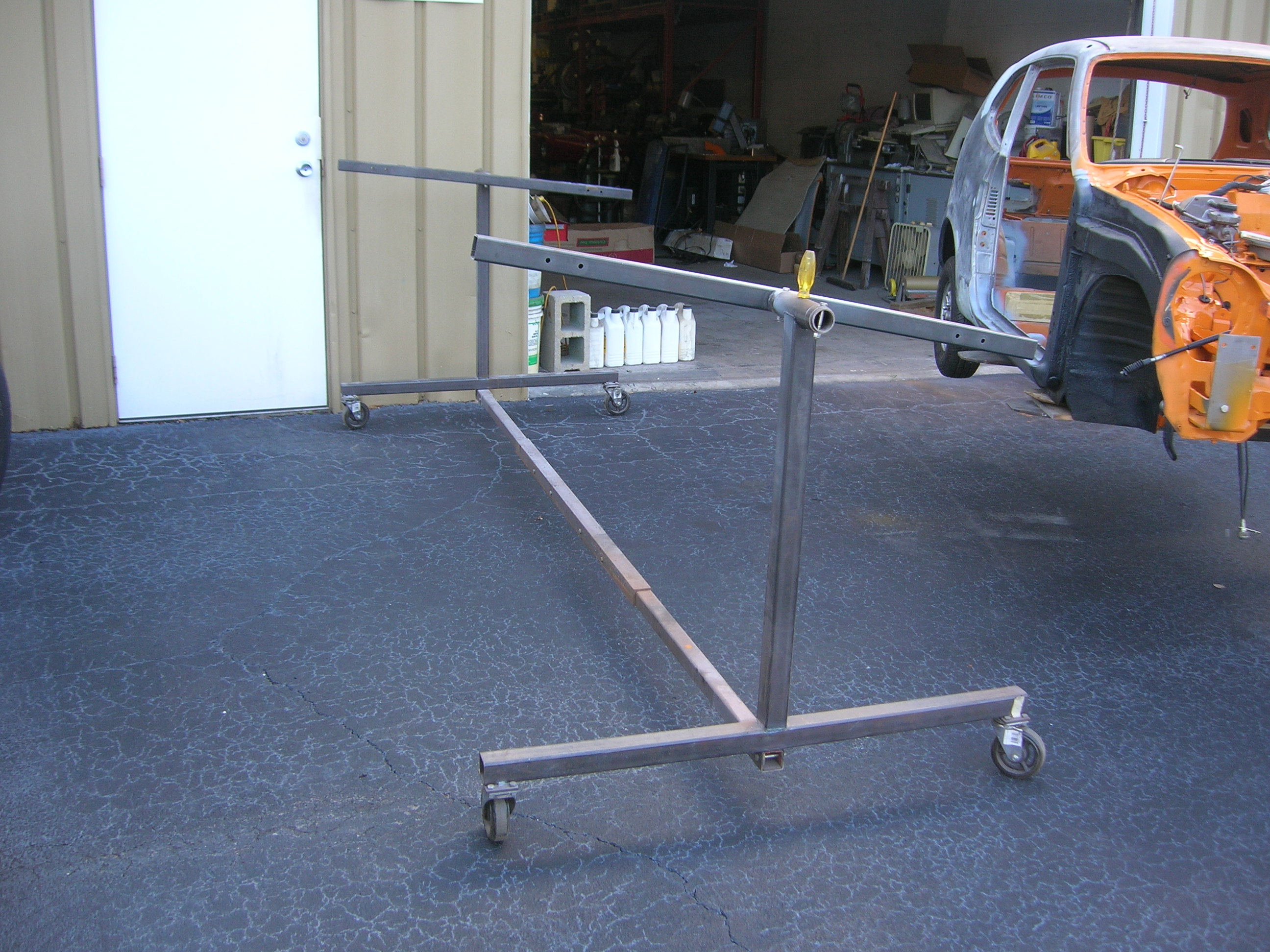

I made one, I can send you pictures if you like.  Dave

Thank's for the response you have given me, looks like i need to order up some box section.
Many Thanks Alan
