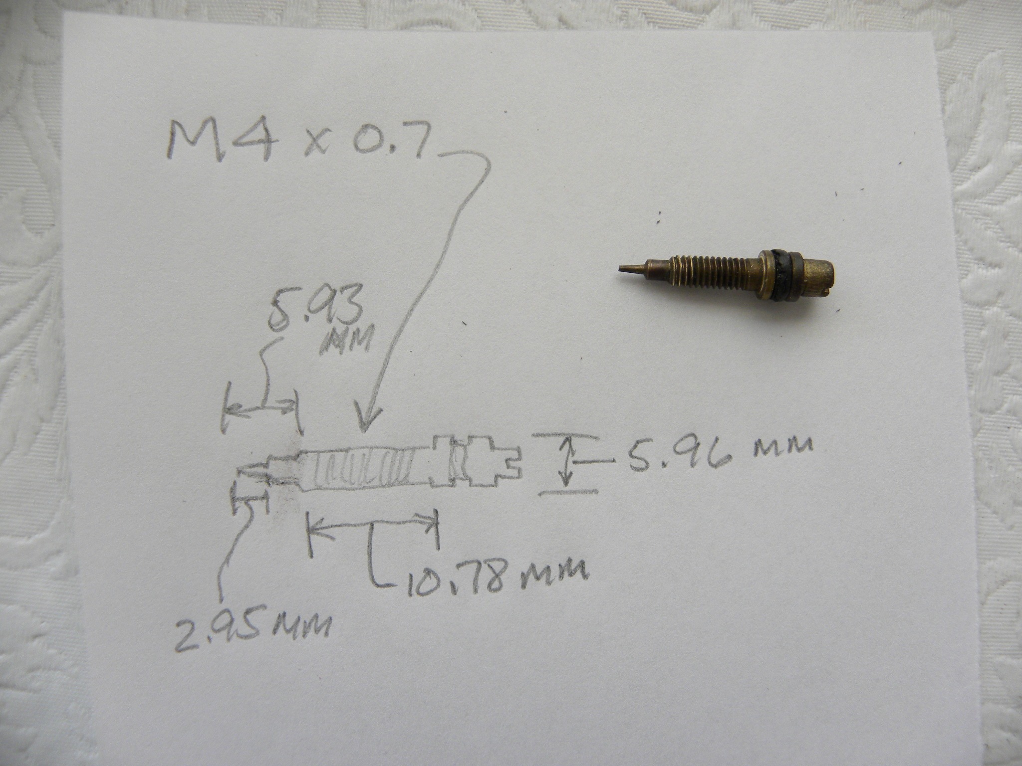

Still on the goose chase, and am posting to see if anyone can help and future reference for anyone with the same problem.
I've called Honda and found that though the pilot screw part number in the manual is 16161-551-014, it was sold in of screws (part number 16016-581-004), neither of which are available through any official channels, and I haven't found any used ones either.
The GL1000 pilot screw does not quite fit, unfortunately, but I am thinking of re-threading the carb to fit it if I can confirm its dimensions are otherwise correct. Is anyone willing to take out their pilot screw and send me its specifications to see if I can match a replacement that way? (it's the late model carb that has the pilot screw enter the carb at a 45-degree angle pointing down)

just realized it would also make more sense if someone could identify what the proper threading for the pilot screw is and then I can re-thread the GL1000 pilot screw I have to fit (if it's the right length which I seems to be) rather than mess with the carburetor itself.

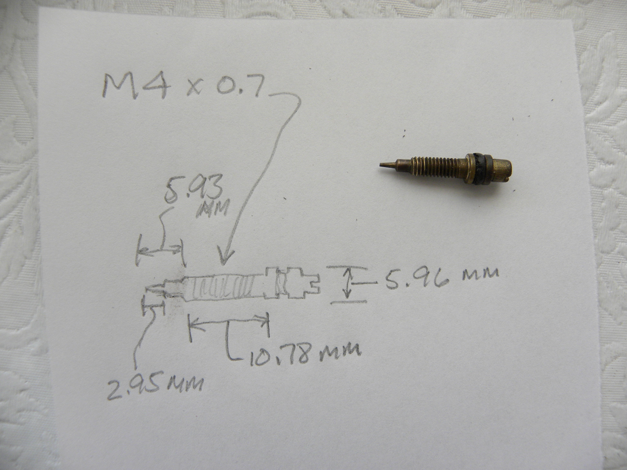

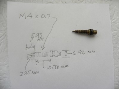

rstevens19
- Posts: 18
- Joined: Thu Dec 15, 2016 3:49 am
Re: Looking for Pilot screw, have spare hood
Hope this helps,
-RS

jamesgayaldo
- Posts: 3
- Joined: Sun Aug 27, 2017 1:06 pm
Thanks mate! You're a boss.
