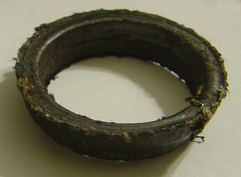

Well I looked everywhere for an exhaust gasket except the obvious place -
still stuck onto the end of the heat exchanger on my old engine! I popped
this off... http://www.honda600coupe.com/exhaust_gasket.jpg
Is this is a stock item? It's not exactly a washer and it's definately not
copper. It appears to be asbestos, and fragile - I guess I shouldn't play
with it too much. Anyway, it's going into the car tomorrow; I figure
that'll settle my leak issue.
Steve
Steve

Re: leaky exhaust joint
Steven;
Look at the two ends connecting the doughnut styled exhaust gasket because
the cover to the gasket is copper the inside is asbestos. There is also a
metal ring (Ferrous metal I believe) under the doughnut shaped gasket. I
have found that if you put it together without that ring there may still be
a leak.
But they fall apart and then you need a new one. Middas had some one time
when I went there in search of something to fit.
