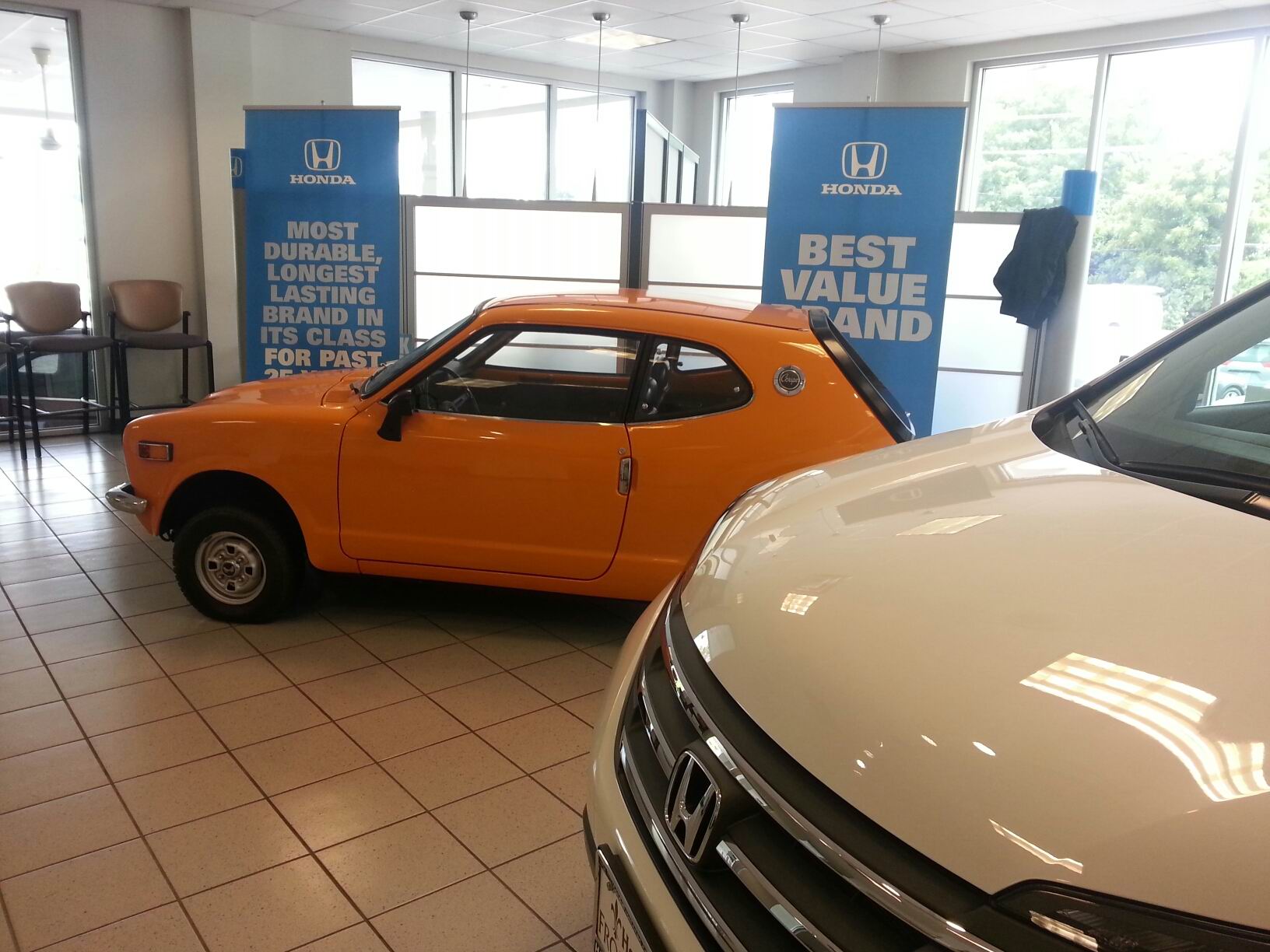

Thanks to several people on here,my "new" 600 is about to hit the road again
I'd like to thank Bill Colford,for all the good advice and parts..Mike O'Connor provided me with a NOS master cly and info..and Greg Alberson for some great parts..
I got my brakes and booster working good tonite..I took apart the booster and it was in like new condition,no fluid leakage,but the piston rod had stuck from sitting,this also cause the front wheels to lock up because the piston rod
position where it stuck prevented the by-pass valve from opening and letting the fluid go back to the master cly...anyway a few raps on the nut on the inside loosened it up and works perfect now...
I hope to be driving late Sunday!
