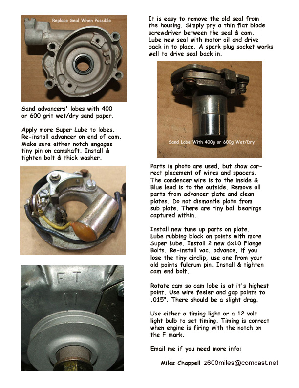

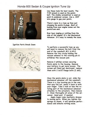

Re: Timing question?
Point gap is .012" to .016" according to the Honda shop manual. I like .015". .032" sounds more like spark plug gap.
